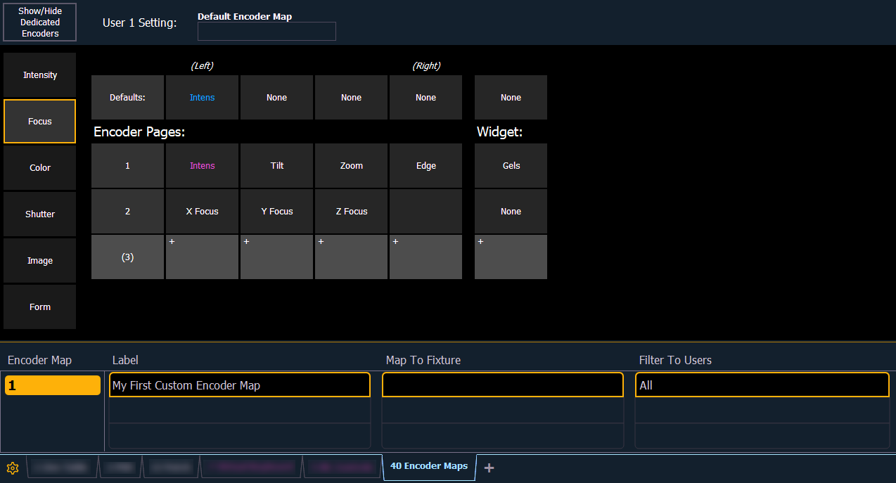

Create a map by entering the map number and pressing [Enter], and select a parameter category (Intensity, Focus, etc) to customize.
Add parameters to the category by selecting an open encoder slot, and choosing a parameter from the list to assign to it. You can also search for specific parameters.
To edit parameters that have already been assigned, select the parameter again and choose from the following options:
  • Clear - removes the parameter assignment from the encoder slot, leaving it blank.
  • Delete - removes the parameter assignment from the encoder slot, moving all subsequent parameters to the left
  • Insert Before - inserts a blank slot to the left of the selected parameter
  • Insert After - inserts a blank slot to the right of the selected parameter
  • Change Parameter - replaces the assigned parameter in that slot
Each parameter category can be given up to 25 pages of custom encoder layouts. If a parameter category is not assigned any custom encoder layouts, the default Eos parameter mapping for that category will be used instead.
Defaults
These parameter slots assign default parameters to each encoder in the specified parameter category. Unless a specific parameter has been chosen for an encoder on a page, the assigned defaults will track across encoder pages, indicated with the standard Eos tracking colors.If the defaults are left unassigned, parameters must be assigned on each encoder page individually.
Widgets
Additional fixture control options can be assigned in the Widget column. As with parameters, widgets can be assigned a default that tracks across all pages in a parameter category, or assigned on a page-by-page basis.

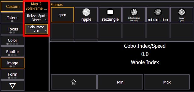

Assign a map to a device profile via {Map To Fixture}, or by selecting in the Map To Fixture column. When fixtures with this profile are selected, the custom encoder map will populate.
If multiple fixture types are selected at once, encoder maps will stack in the encoder display, allowing you to select them individually. This includes any default maps for selected fixtures without custom maps assigned to them.
